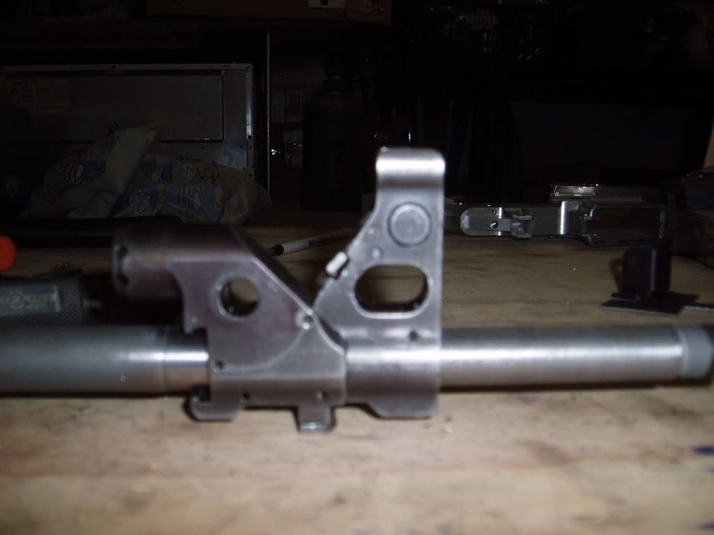

Been wanting to build a receiver out of stainless steel for some time now. No real reason other than "because". Any rate, here's the progress so far: One is a standard AKM fixed stock based off of a flat as a template. The other is based on a Yugo M95 flat template.

Hey 1biggun. Yeah, I've seen where others have done so, but I just wanted to do something different (for me) for a change. I thought that if I was going to try my hand at building one from a piece of sheetmetal, why not do it with stainless? The stainless I selected from McMaster -Carr had good wear, welding, and formability specs, so I'm hoping that I don't have any problems with the bolt galling up on the top rails. I intend to use Duracoat SL on several places, as that's what I've used on my last few builds, and that teflon is slick as snot.
I tell you though, you really have to account for the springback on this stuff, as it sure as heck won't bend to 90 degrees with your regular bending jig. Took me awhile to rig up some stuff to get the sides all the way to 90, but I got 'em!!

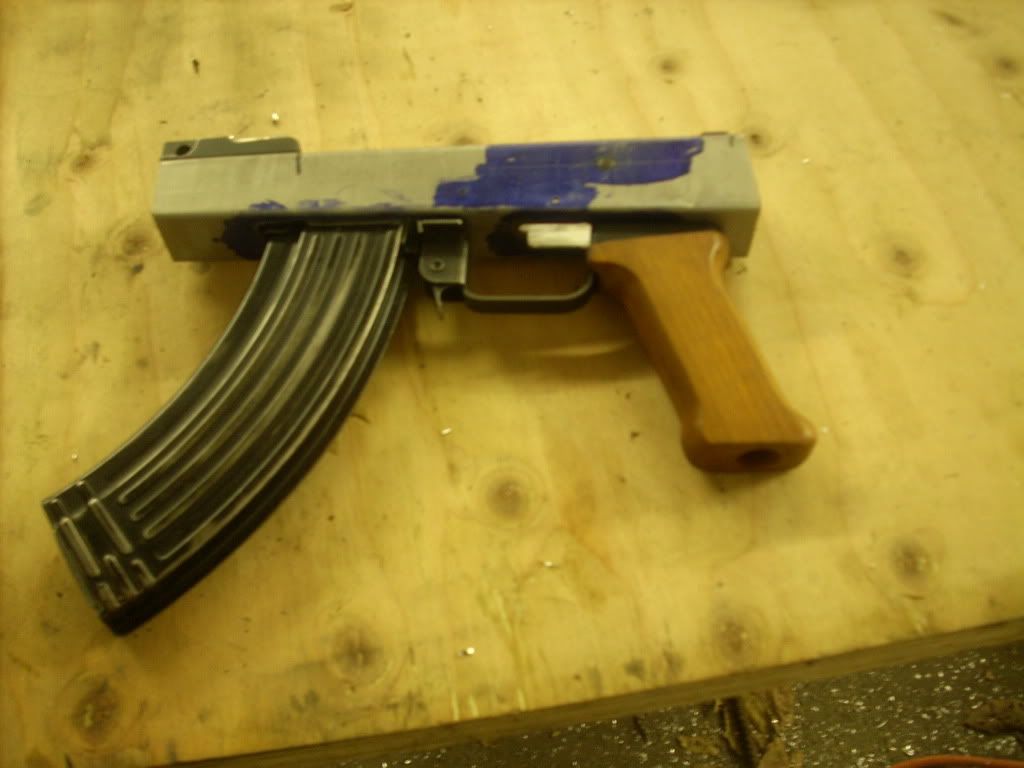

Nice build, I like your style! I'm in the middle of a rivetless SS AK pistol build, Hope this isn't to big of a thread jack.

Wow, looks great Woody!!!! Not hijacking at all. I look forward to anyone else replying with some pics/info from their experiences with stainless.

your trigger guard looks way better than what I did, please do tell how.
