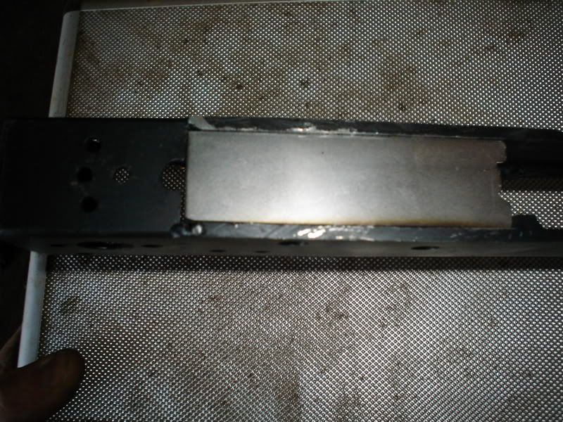

Take your repair plate, bevel the front inside edge with a file dremel or angle grinder like this:
If your repair plate has a recess pre cut for the selector/safety make sure it is the correct distance from the front of the receiver. (trim the front edge of the repair plate to achieve this)
Make sure the repair plate is tight against the keystock and clamp.
Tack weld the front trunnion to the repair piece near the top and bottom. Make sure everything is tight on the plate and against the key stock. If not fix it.
Run a continuous bead top to bottom or bottom to top as you prefer.
Grind or file flat.

Clamp weld and grind smooth:

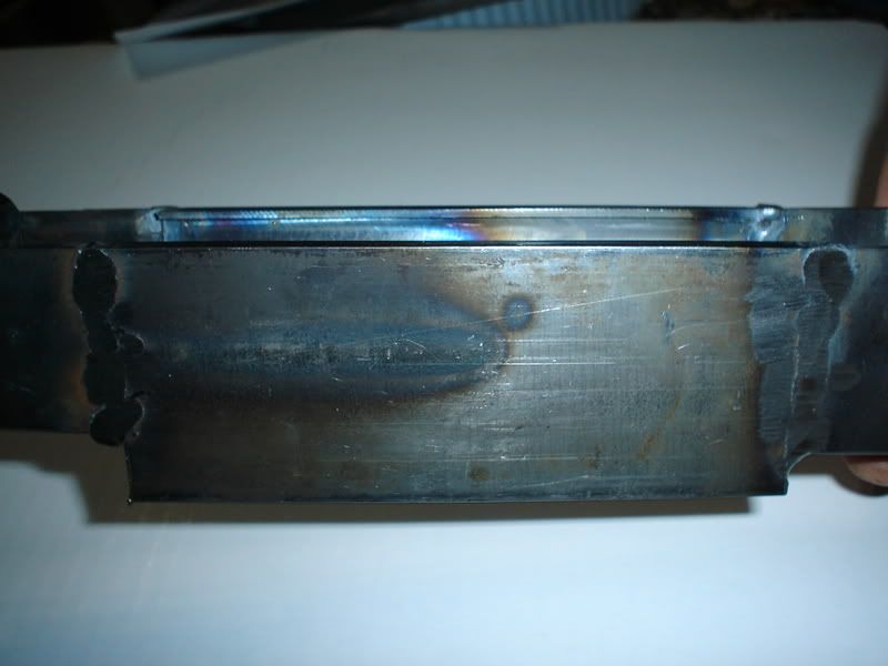

Measure the outside of the front trunnion and the outside of the rear trunnion near the weld. They need to be the same. If they are off take a nut and bolt put them inside and spread the rear trunnion to the correct dimension, leave the bolt in place for now.
Test fit the receiver cover now. If the receiver is too long cut through the rear weld and shorten. If it is too short cut the weld and reweld as well. If it fits well or is *slightly* too tight you're good.
Measure and cut the left repair plate to fit. I like to have a snug fit but not one too long where it bows the right side even slightly. Bevel the inside AND the outside of this plate. Next take your left stamped rail and cut it to length so that the ejector will be 2.300" from the rear of the barrel. Trim as needed, place on the left plate and weld it as you did on the right side then grind/file smooth.
Clamp the receiver on the jig left side down with the top tight against the keystock.
Clamp the left side plate making sure it is tight against the keystock.
Measure the mag well opening, it should be 1.022" or a little more.
Spot weld top and bottom front and rear trunnion from the inside. Remove from jig and check to make sure everything looks right and the cover is correct or slightly tight. Just look it over good to see if it looks straight. Return to jig and weld the inside as best you can (tight quarters here).
While it is clamped, cut a notch about .065" deep with a cut off wheel on an air grinder or on your dremel along the seams of the right side outside welds. Kinda like this drawing:
then weld these from top to bottom. Grind close to smooth.
Flip the receiver over, notch these welds on the left side as you did on the right and weld and grind nearly flat. It should look like this:

If everything has gone well its time to close of the bottom of the receiver. Grab a 1" wide piece of 18 gauge steel (farmsupply shops, Lowes, Home Depot, metal shops etc.) or 4130 if you can find it. It needs to be roughly 3.75" inches long. Grab a magazine and put it in the gun how it will sit. Mark the back edge of the magwell with a sharpie. This will tell you exactly how long to cut the floor.
It should fit something like this:
Grab an extra piece of 12" keystock and clamp the floor plate to it and lay it in the receiver. Level it and spot weld the corners and 1/2 way down the sides. When you are confident it is right notch the joints like you did on the outside side welds and weld.
Now if your trigger guard has the extra pieces sandwiched between it and the floor grind and file your welds till it’s all flush. If you need the raised hump in the receiver, shape this into the bottom (the picture above has this feature)
