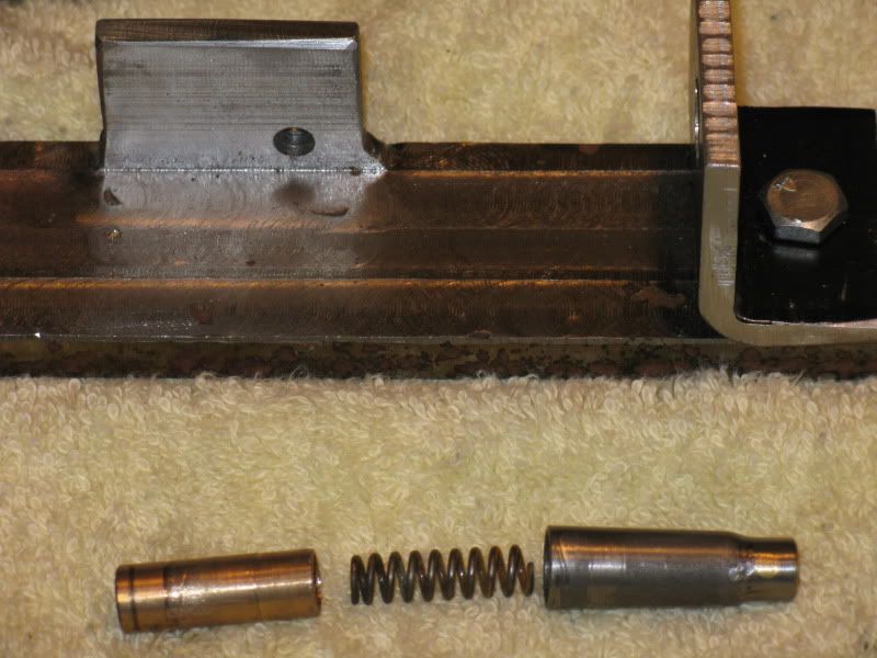

I routinely lap bolts on my pistol conversions when the chamber is a tad bit short. A few simple easily made tools will do the job. Even if you use a file you can then see with the lap how the bolt lugs relationship with the trunnion.
I have a tool that i made that made as wellnthat is for trueing actions Mine a little differant it goes through the trunion bore and pushes down on the bolt to keep it true and I then work the bolt back and forth.
Great minds or is it the mindless think the same.

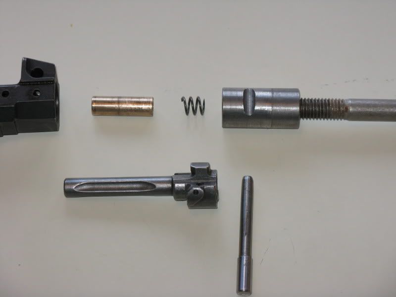

Some pic's of the tool I use to do the trunnions on virgin Trunnions and barrels/ re barreling. Adjustable to increase the pressure if needed.
thats close to what I have. mine has a few differant features but its the same idea.
